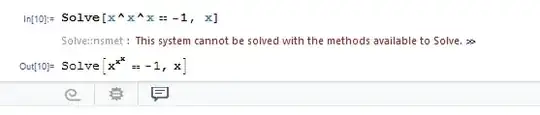

You could then theoretically use the super-root function to solve the equation, but I do not know how to use the super-root function nor do I know of any website online that could calculate that equation.
Mathematica also doesn't help.
Mathematica
So how would you attempt to solve it?

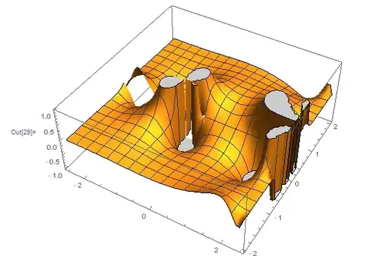

Also, in case anyone is interested, here is the graph for $$z = \Re[(x+iy)^{\Large (x+iy)^{(x+iy)}}]$$
Real tetration
And $$z = \Im[(x+iy)^{\Large (x+iy)^{(x+iy)}} ]$$

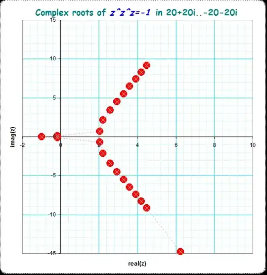

  • It seems, I've now the complete solution for the roots of $ f(x)= ,^3x+1$. I've updated my pdf-file by 3 pages, which are intended to supplement my earlier answer (with the couple of pictures) Perhaps I can re-convert that text into mathjax soon and make a new supplemental answer. Until I can do this I upload the text on my webspace, see https://go.helms-net.de/math/tetdocs/_other/roots_of_xxx_V3_pg9-11.pdf . Critics/enhancements are welcome – Gottfried Helms Aug 28 '22 at 06:46
18
Let's define $$f(z)=\;^3z+1$$ and for an inital evaluation/rootfinder $$g(z) = \log\log(f(z)-1)-\log(\log(-1)) \qquad \text{ or }\\ g(z)=\log\log(z)+z \log(z)-\log(\log(-1))$$ .
When doing root-finding with the Newtonalgorithm, then using $f(z)$ we'll easily run into numerical under- or overflows, so I tried first the rootfinding using $g(z)$. This gave for the range $z=\pm 10 \pm 10î$ the roots $x_0,x_1,x_2$ so initially $3$ solutions.
        x:     roots for g(z)
 ------------------------------------------  initial findings
  x0 = -1                                    (pure red colour)
  x1 = -0.158908751582 + 0.0968231909176*I   (pure blue colour)
  x2 =  2.03426954187 + 0.678025662373*I     (pure green colour)
 ------------------------------------------ update: additional findings
  x_3 =  2.21022616044 + 2.14322152216*I
  x_4 =  2.57448299040 + 3.39212026316*I
  x_5 =  2.93597198855 + 4.49306256310*I
  x_6 =  3.27738123699 + 5.51072853255*I
  x_7 =  3.60013285730 + 6.47345617876*I
  x_8 =  3.90713751281 + 7.39619042452*I
  x_9 =  4.20091744993 + 8.28794173821*I
  x_10 =  4.48346951212 + 9.15465399776*I
  x_11 =  4.75636133031 + 10.0005052039*I
by checking the range -10-10i to 10+10i in steps of 1/20 with 200 decimal digits internal precision.
These are so far "principal" solutions, where "principal" means, we do not ponder the various branches of the complex logarithm.
The Pari/GP-routines are (in principle, much improved to draw the picture)
fmt(200,12) \\ user routine to set internal precision(200 digits)
            \\ and displayed digits
lIPi=log(I*Pi)
myfun(x)=local(lx=log(x));log(lx)+lx*x
mydev(x) =local(h=1e-12); (myfun(x+h/2)- myfun(x-h/2))/h
{mynewton(root,z=lIPi) =local(err); for(k=1,150, err= precision((myfun(root)-z)/mydev(root),200); root = root-err; if(abs(err)<1e-100,return(root)); ); return([err,root]);}
{for(r=-10,10,for(c=-10,10, z0= c -r*I; if(z0==-1,print(z0);next()); if(z0==0 | z0==1 ,print(z0," fixpoint!");next()); print([z0,mynewton(z0)]); );}
Here is a plot of the array of the complex initial values $z$ from $-10+10î \ldots 10-10î$ leading to the solutions $x_0,x_1,x_2,... x_{11}$ for roots-finding on $g(z)$ and some cases did not converge. The pure blue colour mark the area, for which $x_1$ is attracting for the Newton-iteration, the pure green colour mark the area, for which $x_2$ is attracting, the pure red colour where $x_0=-1$ is attracting. The other roots have modified/mixed colours. The shading shows roughly the number of iterations needed, the less iterations the lighter is the colour. *The iteration had to exclude the fixpoints* 1,0,-1 *to avoid infinite number of iterations.* *** root-finding for $g(z)$ ***
[![bild1][1]][1]
(There are some spurious dots, not visible in the picture, these are coordinates where the Newton-iteration did not sufficiently converge)
Here are the locations of the first 12 found roots so far. It suggests, we'll find infinitely many...

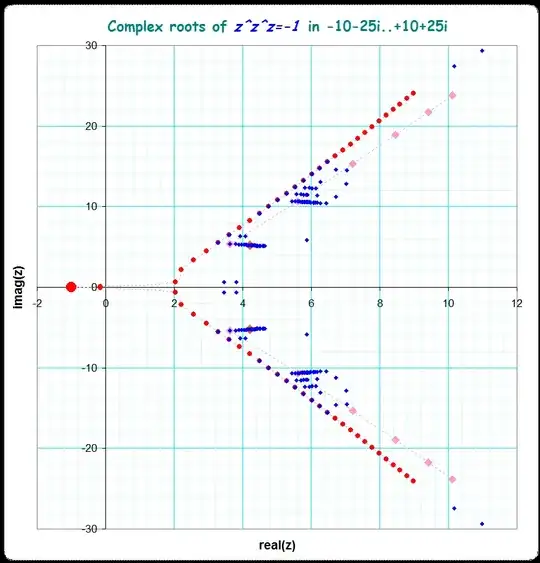

update 2020 After we see that the roots occur nearly in line when $\text{real}(x_k)>2.5$ I took then another simpler search routine to fill the gaps, where the initial value in the newton-algorithm for $\;^3 x_k - (-1) \to 0$ inserted for $x_{k+1}$ is guessed as linear continuation from $x_{k-1}$ to $x_k$ : $x_{k+1, \text{init}} = x_k + 0.97 (x_k-x_{k-1})$.
I got now
        x
x_0 = -1
x_1 = -0.158908751582 + 0.0968231909176*I
x_2 =  2.03426954187 + 0.678025662373*I
x_{k+1} ~ x_k + (x_k-x_{k-1})*0.96  as initial value for the Newton
                                      algorithm on xk^xk^xk - (-1) => 0
Of all of this likely infinitely many roots their complex conjugates are as well roots.
update 2020 jan (2)
A finer analysis detects more complex roots aside of the indicated location in the previous picture. It seems that there are further roots rather arbitrarily scattered in the right half plane. I the following picture I just find a second linear looking region (green dots) and a third region (blue dots) and some more scattered roots but which I didn't document here.
Here is the improved picture: picture

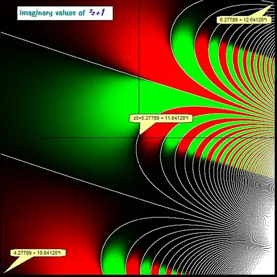

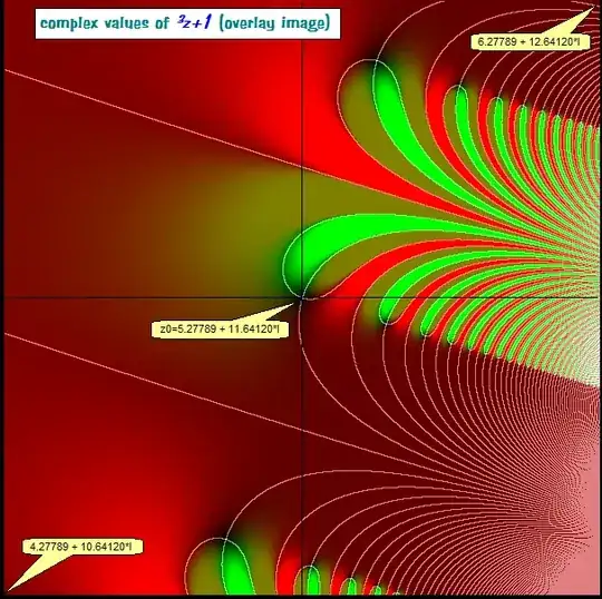

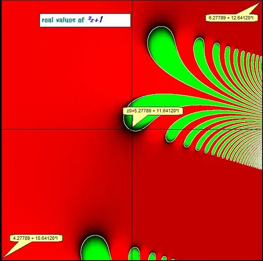

update 2020 feb (1) The rough structure in the scattering of the roots for $f(z)$ made me suspecting that the roots might lie somehow on dotted lines and looking at the imaginary and the real parts of $f(z)$ separately the resp roots might be connected by continuous lines. This seems to be true; I show three pictures. This pictures show the neighbourhood of a known zero $z_0 \approx 5.277 + 11.641î$ with $\pm$ one unit extension.
First picture $real(f(z))$ : green color indicates negative values, red color positive values. Small absolute values dark, large absolute values light. Where neighboured dots have alternating sign I draw white points, indicating continuous lines of zero values:
second picture $imag(f(z))$. Again we find continuous lines with zero value:
Now the overlay shows discrete locations for the complex zeros of $f(z)$ as met in the recent investigation; they are just on the points, where the white lines from the real and from the complex images intersect:
Interesting the further structure of the roots-locations: that slightly rotated rectangular shape towards the south-east of the picture.
But I think I'll go not further in this matter -with that findings someone interested and talented might dive deeper in this and give bigger pictures and/or more insight.

  • How can x4, x6, ... be in the middle of the green basin (first image)? – Wolfgang Feb 02 '20 at 15:19
  • @Wolfgang - maybe there are some errors in the picture. I made this while discovering the existence of roots and had a difficult fiddle to develop appropriate algorithms, without peer review. Maybe there's something wrong - I'll recheck this in the following days. My recent attempt to make things flat in http://go.helms-net.de/math/tetdocs/_other/Roots_of_xxx+1_comments.pdf explains something better and possibly avoids by this errornous claims. I need to look at the problem you've indicated tomorrow. Thanks for the hint! – Gottfried Helms Feb 02 '20 at 17:04
    The picture is more than beautiful - you shouldn't delete it - but obviously corresponds to a different iteration. And it should also be symmetrical wrt the real axis, shouldn't it? – Wolfgang Feb 02 '20 at 21:34
  • @Wolfgang - I think I've got the idea of the first picture correctly from my Pari/GP-sources and from the comments and rephrased the text now explicitely introducing the function $g(z)= \log(\log(f(z)+1)) - \log(\log(-1))$ which has been the base for the provisorical "Newton-fractal" (picture 1). I've also improved the root-finding for $f(z)$ without using Newton-iteration, by combining the contourplots for the roots of $real(f(z))$ and roots of $imag(f(z))$ getting the roots at the intersection-points of continuous lines somehow as an infinite lattice. (last pic) I think this is better now... – Gottfried Helms Feb 07 '20 at 08:02
    Yeah, the last pictures look much more as what one should be expect for such an infinite sequence of roots with supposedly a "regular" pattern (in terms of monotonicity, monotonicity of neighboring differences etc.), unlike e.g. the zeta zeros. – Wolfgang Feb 07 '20 at 11:51
