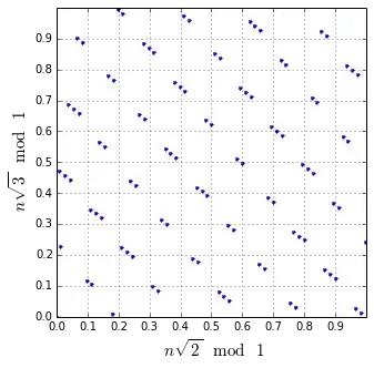

For example $n = 100, a = \sqrt{2}, b = \sqrt{3}$. Try to get an error within $\frac{1}{10}$.
