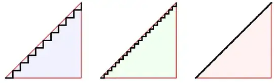

As your friends are non-mathematical, you might try examples they can understand--simple paradoxes. For example if the base and height of the red triangle is 1, then the length of each staircase below is two, so we have a simplistic argument that 2 = $\sqrt{2}$. This error, from a lack of rigor, would cause major troubles with Google maps, measuring to build a building ... (trying to stay non-mathematical here). There are many such easy paradoxes.
(I know this argument is wrong--the points is lack of rigor can be dangerous)
Added per @Steven's comments below:
There are times at which such naive dissection do give the correct answer, such as when we dissect a circle of radius $r$ into arcs and rearrange them into an approximate rectangle of (limiting) height $r$ and width circumference/2 = $\pi r$.
Without rigor, we can not know when to trust our 'reasoning'.
  • Maybe it be interesting to include some basic geometrical insight that $ds \neq dx+dy$ but rather "$ds^2 =dx^2+dy^2$" which is not rigorous but rather intuitive. – Pedro May 01 '12 at 17:07
  • @PeterTamaroff it might, but then you are bringing in the missing rigor, I thought the point was to show missing rigor causes big problems! My suggestion is just do it on a third grade level instead of using one of the other very impressive answers here that may not convince the non-mathematical. – Chris K. Caldwell May 01 '12 at 17:09
  • @Chris I see. ------------ – Pedro May 01 '12 at 17:12

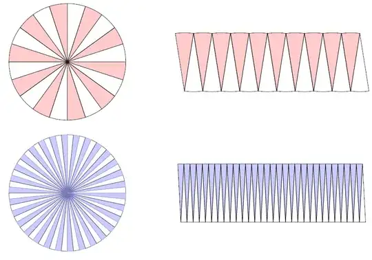

    This example can be usefully combined with that proof that the area of a circle is $\pi r^2$ which cuts the circle up into wedges and rearranges them to form an approximate parallelogram. That argument asserts that the limiting rectangle is $r\times \pi r$, but the naive argument for these dimensions assumes that arclength is preserved under limits, which the above example shows is not the case in general. So why is this idea right in one argument but wrong in the other? Getting to the bottom of this requires getting more rigorous. –  May 01 '12 at 17:55
