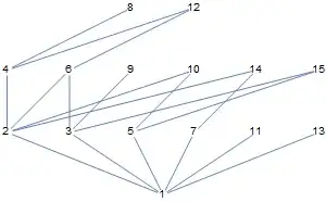

How would you draw a Hasse diagram of the divisibility relation? when A = {1,2,3,4,5,6,7,8,9,10,11,12,13,14,15} Any help would be appreciated, thank you.
  • Write the element 1 at the bottom. At one level above, write the primes $2,3,5,7,11,13$, and draw a line from each of them to the element 1. At the second level above, write all elements that are a product of two primes, and draw a line from each of these elements to their prime factors. For eg, a line from 9 to 3, one from 6 to 3, one from 6 to 2, etc. Then lines from 12 to its factors 4, 6 in the level below it... – Ashwin Ganesan Aug 06 '15 at 11:48
