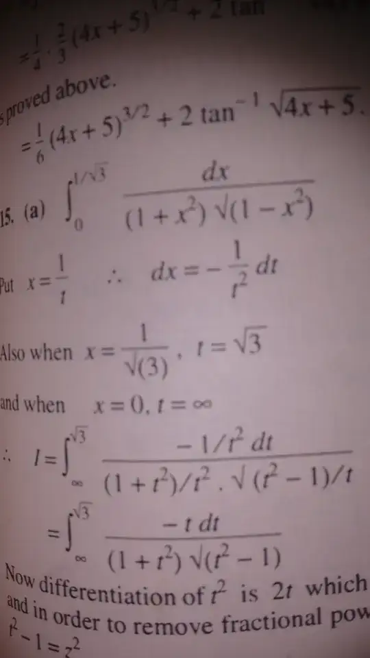

Now see that book says when $x=0$, $t=\infty$. If it is wrong, why did they just write it?

  • My book says that (while addressing an integral problem)- $x=t^{-1}$, so when $x=0$ then, $t=\infty$ So is it right? – Aditya Agarwal Aug 02 '15 at 13:00
    @AdityaAgarwal No it is blatantly wrong. At least wrong in the context of calculus. – user103816 Aug 02 '15 at 13:03
  • But then why does the answer come out to be right? – Aditya Agarwal Aug 02 '15 at 13:05
  • Because the book actually had to write, when $x \to 0$ then, $t \to \infty$. – user103816 Aug 02 '15 at 13:06
  • ? But then I dont think there is any other method? Wait, let me post the image. – Aditya Agarwal Aug 02 '15 at 13:08
  • As per the definition of definite integral, if the integrand at any point between or at the integration limits $x=x_a$ is undefined then we can just skip the point but not its whole neighborhood. So what the book had to do was just skip $ x=a\ (\text{or}\ t= \infty)$ and take the limit $x_0 \to 0\ (\text{or}\ t_0 \to \infty)$. Check out improper integral. – user103816 Aug 03 '15 at 01:28
