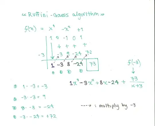

A way cooler algorithm is as follows:
Complete the polynomial to get
$${x^4} + 0{x^3} - {x^2} + 0x + 1$$
Now arrange them in the following table, with the root of the dividend (i.e $-3$)
$\LaTeX$ coding beats me here, so this is what I can give you
This algorithm is very useful when dividing by monic binomial expressions $x-a$, plus, the remainder is $f(a)$, which helps to find the roots of certain polynomials when the remainder is $0$.
It seems english-speaking sites simply call it synthetic division, without mentioning Paolo Ruffini. In Argentina we call it "Ruffini's Rule".
