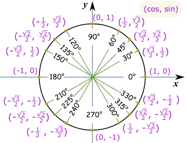

You can look up cos and sin on the unit circle.
The angles labelled above are those of the special right triangles 30-60-90 and 45-45-90. Note that -315 ≡ 45 (mod 360).
For tan, use the identity $\tan{\theta} = \frac{\sin{\theta}}{\cos \theta}$.
