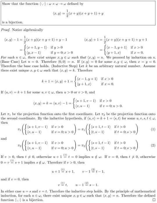

Mathematical Induction
(if anyone is up to it, replace this picture with genuine MathJax)
