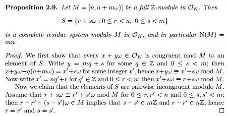

In the quadratic case there is a well-known test for showing that a module is an ideal, e.g. see section 2.3 for Lemmermeyer's notes. Then writing the ideal as a $\mathbb Z$-module in Hermite normal form makes the norm obvious - see below. For complete details in the higher degree case see the discussion on Hermite and Smith normal forms in Henri Cohen's A Course in Computational Number Theory.
