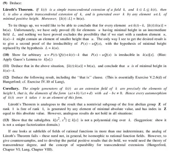

This and related results are frequently called "Lüroth's Theorem". Searching on that term will turn up much of interest, e.g. this stimulating exercise set of George Bergman, which I append below for those who may not have easy access to a postscript viewer. See also the MO thread on elementary proofs. enter image description here enter image description here
