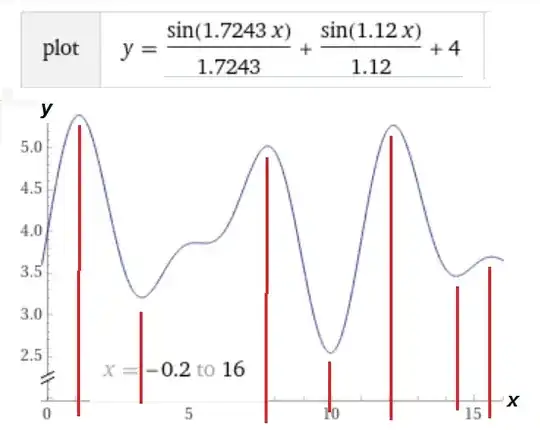

EDIT 1:
I was trying to say about the real part of the complex root. We need be totally lost when helped by the graph of the function. The real root still hangs around an expected location.
If you sketch a graph of $ y = x^3 + 8 $ , it is seen cutting x-axis not only at real x = -2 but the complex roots have real parts coming closest/ farthest to x-axis near about x= 1 when not actually cutting x-axis... depending on lack of harmonicity.
At these points you have complex roots $ 1 \pm i \sqrt {3} $ exactly. $ A view in Complex plane shows all the three positions of vector tip in a WA plot ( not shown here).
To illustrate, I took an irregular graph the red lines point to location of real part of existence of the complex roots.
There are 3 ways non-contacting and intersecting/.. or .. convex/concave $ \cup, \cap $ sort of shaped curves aspected to x-axis in a graph appear e.g., like when $ y=\cosh x, x (1-x), x^6$ respectively. Correspondingly imaginary solutions are odd multiples of $ i \pi/2 $ along with the regular real roots$ (0,1)$ appear..the former non touching cup shapes produce complex roots. The tangential roots are well known.
For $ y(x)= x^3+8 , y^{''}=6x=0 $ a maximum and minimum of y=(x) should occur to the right and left of $x=0$ and complex roots whose real parts should appear nearer to the red abcissas. Exact complex roots can be calculated numerically accurately of course by Newton-Raphson like procedures however.

  • I don't understand what you mean by y = x^3 + 8 "comes closest to x-axis near about x = 1". Huh?? I do understand why that would be nice, seeing how 1 is the real part of the two nonreal zeros. But y(1) = 9 "seems close to x-axis compared to y at other x values"? What am I missing here? – Dr. Michael W. Ecker Dec 12 '21 at 07:36
  • Sorry. The real root presents no problem but about complex root I should have explained better at that time. Re-edited the answer. Please feel free to further comment further if lacking in clarity ( which perhaps it still does.) – Narasimham Dec 12 '21 at 20:41
