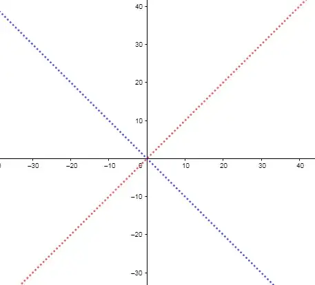

Also, OP can't figure out a nowhere monotone function. I have one beautifull example >:)
$$ \mbox{Let be }f\colon\mathbb{R}\to\mathbb{R}\mbox{ such that }f(x)=\begin{cases} x, & \mbox{ if } x\in\mathbb{Q} \\ -x, & \mbox{ if } x\notin\mathbb{Q} \end{cases} $$
such beautifull funtion, is isnt?
