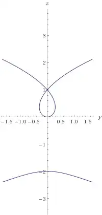

As for your concrete example, to find $(y,z)$ such that the point $((x,0),(y,z))$ is on the parabola, you can either solve for $t$ such that $(x+t,it)$ satisfies $Y=X^2$ and translate $(x,0)$ by $2(\Re t, -\Im t)$ (or $2\bar t$ with the slight abuse of notation),
or you can find the complex coordinates of $((x,0),(y,z))$ and write $Y=X^2$. This gives you two equations, use one to eliminate $x$, and you will obtain a degree $4$ equation on $y$ and $z$, which if I'm not mistaken, is
$y^2(1+z)^2+2y^2(1-z^2)+(y^2-z^2)(1-z)^2 = 2z(1-z)^2$
The node corresponds to the two complex points $((\pm \sqrt 3,0),(0,1))$ so they are the images of $(\pm \sqrt 3,0)$ by the reflection.
