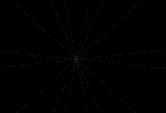

When all non prime numbers are suppressed this ray pattern appears at a specific point (manipulating the increments of the spiral): enter image description here
It turned out that the increment of the angle is exactly $$\cfrac{\pi}{30}$$
All prime numbers are on 16 lines (ignoring that the first numbers probably don't match the scheme).

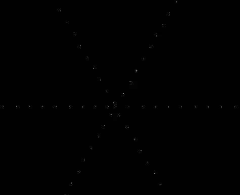

Setting the increments to $$\cfrac{\pi}{3}$$
leads to (white dots are prime numbers):
Mirroring them on the x-axis doesn't seem to help to have them on a single line. Because there are some non prime numbers in the lines.

In your last picture, it's easy to see that all numbers lie on the 6 rays through the origin. Why? This is because there are $2\pi$ radians in a circle, and you are incrementing by $\pi/3$ radians each time (which is 1/6 of the circle). This is why you are getting distinct rays.
The other behaviour occurs when you only look at primes. In the second picture (the one consisting of only primes), there is space for 60 rays (since you are incrementing by $\pi/30$ radians, which is 1/60th of a circle each time). So the new question is, why do only 16 rays appear?
The answer is that $\varphi(60) = 16$, meaning that there are only 16 residue classes for primes to fit in mod 60. Stated differently there are only 16 solutions to $p \equiv x \pmod {60}$ in $x$, where $p$ ranges across all the primes. So there are 16 distinguished rays containing primes.
Similarly, there are two distinguished rays in the last picture, which is why you can only see primes on 2 of the rays.

Loosely, what's going on here is that you're discovering the notion of residue class. If you look carefully, you'll discover that all of the points on your original spiral actually lie on a finite set of 60 lines through the origin: one line for every $6^\circ$ or for every $\frac\pi{30}$ radians. This means that what line a number is on is determined by its remainder when divided by $60$: $19$ is on the same line as $79, 139, 199, \ldots$ For convenience's sake, we'll label these lines by the smallest positive number on them (this is called the residue class of all the numbers on the line, $\bmod 60$). Now, consider:
  • Every even number (greater than 2) remains even after adding 60 to it, so none of your 'even' lines hold more than possibly one prime. This means that no primes (other than just one transient one that we can ignore) can be on the lines with labels $0, 2, 4, 6, 8, 10, \ldots, 56, 58$.
  • Every multiple of 3 (greater than 3) remains a multiple of 3 after adding 30 to it, so none of the multiple-of-three lines hold more than possibly one prime; so no primes (again, except for that one ignorable exception) can be on the lines with labels $3, 6, 9, \ldots, 54, 57$.
  • And the same thing happens with multiples of 5, so we get no primes on the lines with labels $5, 10, 15, \ldots, 50, 55$ either.
Once you take all these into account, you'll find that the only lines that can possibly have infinitely many primes on them are the lines labeled $1, 7, 11, 13, 17, 19, 23, 29, 31, 37, 41, 43, 47, 49, 53, 59$ - these are the sixteen lines you find in your ray pattern.

This implies, though, that every positive integer will have to lie on the same line, not just the primes. Actually, this is already happening even in your last picture: if you plot the other numbers as well and not just the primes, you will see that they lie in the same $$ 6 = 2\pi \cdot \frac{3}{\pi} $$ rays, too.
