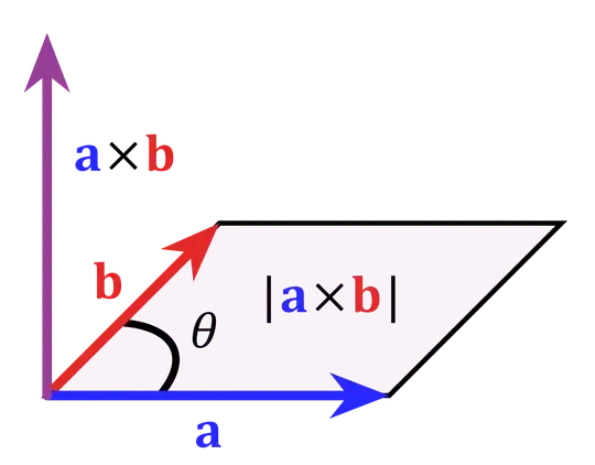

Here is a basic picture of what we will be doing:
We will get the area of this parallelogram and then half it
Once you have both vectors you can calculate their orthogonal vector by taking their cross product, you do it as follows:
$$\vec{u} = \vec{P_1P_2} \times \vec{P_1P_3}$$ $$\vec{u} = \begin{vmatrix} \mathbf i & \mathbf j & \mathbf k \\ x_1 & y_1 & z_1 \\ x_2 & y_2 & z_2 \\ \end{vmatrix}\\ $$
$$\vec{u} = \begin{vmatrix} y_1 & z_1\\ y_2 & z_2 \end{vmatrix}\mathbf i - \begin{vmatrix} x_1 & z_1\\ x_2 & z_2 \end{vmatrix}\mathbf j + \begin{vmatrix} x_1 & y_1\\ x_2 & y_2 \end{vmatrix}\mathbf k $$
This boils down to:
$$\vec{u} = (y_1z_2-y_2z_1)\mathbf i-(x_1z_2-x_2z_1)\mathbf j+(x_1y_2-x_2y_1)\mathbf k\\= \ <y_1z_2-y_2z_1,\ x_1z_2-x_2z_1,\ x_1y_2-x_2y_1> \\= \ <x_3,y_3,z_3>$$
Once you have the orthogonal vector from the cross product, we calculate its magnitude:
$$|\vec{u}| = \sqrt{(x_3)^2+(y_3)^2+(z_3)^2} = \mathbf{Area\ of\ Parallelogram}$$
Finally we are left with the area of a parallelogram composed of two of our triangles. At this point we half the magnitude, and we will have the desired result.
$$\frac{|\vec{u}|}{2} = \mathbf{Area\ of\ Triangle}$$
