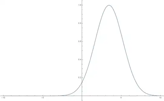

If we were to integrate this particular expression on both sides, we'd get a parabola. While it perfectly does what we want it to do, achieves a peak and falls off symmetrically (if we make sure $k < 0$), it doesn't stop at $0$. We can't have that. We need to establish a ratio which always keeps the function above water, above $0$. Fortunately, this is very easy:
$$\int_{-\infty}^{\infty}{\frac{p'(x - \mu)}{p(x - \mu)}\space dx} = 0$$
You can easily see that it proportionally changes the values on both sides (because it is symmetrical), therefore integrating this expression still yields $0$. Continuing from there, we've setup the expression to fall into our trap:
$$ \frac{p'(x - \mu)}{p(x - \mu)} = k(x - \mu)$$
And from here we simply integrate both sides and pick up the candy from the floor:
$$ \int{\frac{p'(x - \mu)}{p(x - \mu)}} \space dx = \int{k(x - \mu)} \space dx \Rightarrow \ln{p(x - \mu)} = \frac{-k(x - \mu)^2}{2}$$ $$\LARGE p(x - \mu) = e^{\frac{-k(x - \mu)^2}{2}}$$
Do note that we're far from done, as a probability density function must be normalized before it can be of any use.

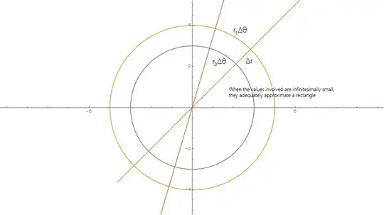

Now, we need to clean this up into something functional. First of all, we will need to have a way of separating the two $x$ variables, simply by calling the right one $y$. It changes nothing beyond improving readability and also allows us to reinterpret the problem in terms of area. As the mean $\mu$ is constant, we can introduce a substitution with no repercussions. Therefore, let $x_{\mu} = x - \mu $ and $y_{\mu} = y - \mu $. Also, we shall now commit to the infinite range with $a = \infty $. Here it is combined:
$$ \int_{-\infty}^{\infty} \int_{-\infty}^{\infty} e^{\frac{-k}{2}x_{\mu}^2} e^{\frac{-k}{2}y_{\mu}^2} \space dx_{\mu} dy_{\mu} = \int_{-\infty}^{\infty} \int_{-\infty}^{\infty} e^{\frac{-k}{2}(x_{\mu}^2 + y_{\mu}^2)} \space dx_{\mu} dy_{\mu} = \frac{1}{n^2}$$
Attacking the problem as if we were integrating over area, we can see something familiar popping up in the exponent. This suggests a possible avenue of solving the problem in a more susceptible coordinate system, such as the polar. First step is to notice $r^2 = x_{\mu}^2 + y_{\mu}^2$. Expressing area in polar coordinates is not that different from expressing them in spherical coordinates, I took the liberty to make you a fancy graph below where you can see where $\mathbf{d}A = \mathbf{d}x \mathbf{d}y = r \mathbf{d} \theta \mathbf{d}r $ comes from. Changing the integration range is simple, $r$ cannot be negative because it makes no sense for radius, enforced by the squares (the upper bound is still $\infty$). $\theta$ goes from $0$ to $2\pi$.
And here is what we've discussed in the previous paragraph combined:
$$\int_{0}^{\infty} \int_{0}^{2\pi} e^{\frac{-k}{2}r^2} r\space d\theta dr = \frac{1}{n^2}$$

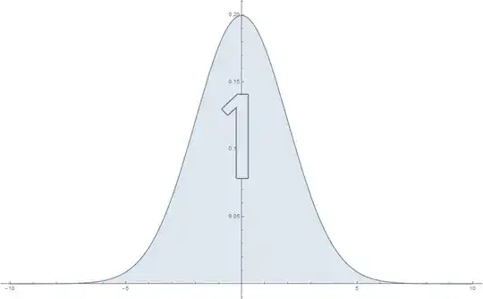

And our normalized $p(x - \mu)$ is therefore:
$$\LARGE p(x - \mu) = \sqrt{\frac{k}{2\pi}} e^{\frac{-k(x - \mu)^2}{2}}$$
Beautiful. And you could analyze the behavior of the function to establish the deviation and variance, I'll just give you the final values which you can use to check your little exercise:
$$k = \frac{1}{\sigma^2}$$
$$\LARGE p(x - \mu) = \frac{1}{\sigma\sqrt{2\pi}} e^{-\frac{(x - \mu)^2}{2\sigma^2}}$$
In the example below is the final function's graph with its area colored in blue, which has now reached unity. Parametrization used is $\mu = 0, \sigma = 2$.
