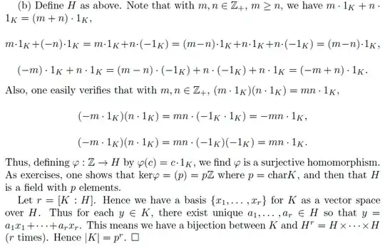

I am trying to get my head around the proof of the following:
Suppose K is a finite field. With $p=charK, |K|=p^r$ where r is a positive integer.
I am supplied with the following proof:
I do not understand how this proves what we are required to prove and I;m not satisfied with the last paragraph, can anyone offer some explanation?
Mark
  • 1,413
If $F$ is a subfield of $K$ then $K$ is an $F$-vector space. In the finite case, $r:=\dim_F K$ is certainly finite, which makes $K\cong F^r$. Now $\operatorname{char}K=p$ means precisely that $K$ contains a subfield $F$ of cardinality $p$. Hence $|K|=|F|^r=p^r$.
