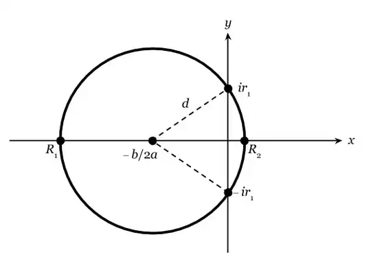

Consider the image below. Quadratic Roots on Hyperbolic Plane
The roots of $f(x)=ax^2+bx+c$ will lie on the circle in the complex plane whose center is $\dfrac{-b}{2a}.$ In the case where both roots are real numbers, they will lie on the real line at $R_1$ and $R_2.$ In the case where the roots are purely imaginary, they will lie on the vertical axis at $ir_1$ and $-ir_1.$ Now we want to find $d$ the radius of the circle.
To do this, note that the product of the roots of $f(x)=ax^2+bx+c$ is $\dfrac ca.$ So in the case that the roots are purely imaginary, we have $$\frac ca=(ir_1)(-ir_1)=r_1^2,$$ And thus $r_1=\sqrt{\dfrac ca}.$ Note these roots will only occur when $b=0$ and $ac>0.$
Now to find the distance $d,$ we use the Pythagorean Theorem to get
$$d^2=\left(\frac{-b}{2a}\right)^2+\left(\pm i\sqrt{\frac{c}{a}}\right)^2=\frac{b^2}{4a^2}+\frac{-c}{a}=\frac{b^2-4ac}{4a^2},$$ and thus $$d=\frac{\pm\sqrt{b^2-4ac}}{2a}.$$
In the case where the roots are both real, for $b^2>4ac$ we have $$R_1=\frac{-b-\sqrt{b^2-4ac}}{2a},\quad\text{and}\quad R_2=\frac{-b+\sqrt{b^2-4ac}}{2a}.$$
One may struggle or take issue about the above argument, since $d$ is not a distance as traditionally defined in the complex plane. See related question:
Pythagorean Theorem for imaginary numbers
It should be noted that my notion of distance is being done on the hyperbolic space. In both the Euclidean plane and the Hyperbolic plane, the distance between points on the real line is the same. But once we venture off the real line we get different versions of the Pythagorean Theorem.
In Euclidean space, we have $\cos^2t+\sin^2t=1\Longrightarrow a^2+b^2=c^2.$
In Hyperbolic space, we have $\cosh^2t{\color{red}-}\sinh^2t=1\Longrightarrow a^2-b^2=c^2\equiv a^2+(\pm ib)^2=c^2.$
