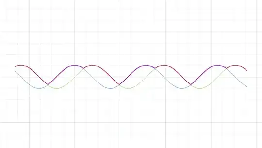

No, $h(x)=\max(\cos x,\sin x)$ is not differentiable at $x=\dfrac\pi4+k\pi$.
This is because when you switch from $f$ to $g$, the slopes have no reason to be equal.
