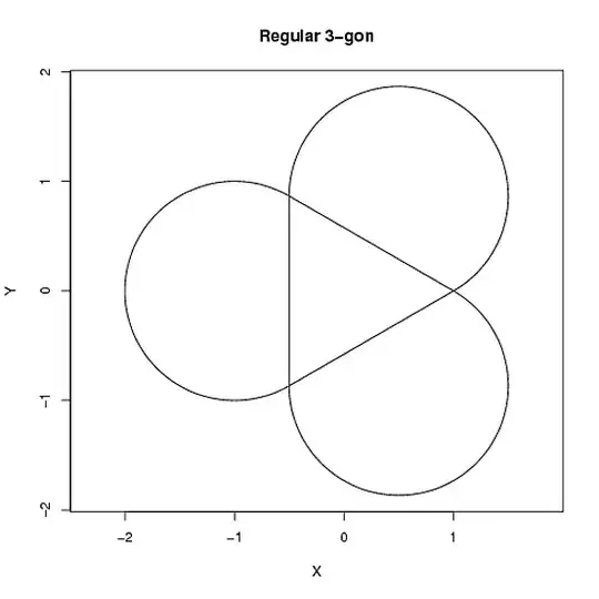

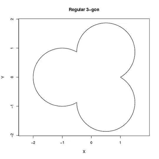

I cannot understand the order of the division yet. I can understand the radius part but not why a line in the triangle, it must be due to some identity. Look I could do this with a small change (reciprocal of the radius):
n=3;
theta=(0:999)/1000;
r=cos(2*pi*(n*theta)%%1/n-pi/n)/cos(pi/n);
plot(r*cos(2*pi*theta),r*sin(2*pi*theta),asp=1,xlab="X",ylab="Y",
        main=paste("Regular ",n,"-gon",sep=""),type='l');
n=3;
theta=(0:999)/1000;
#r=cos(pi/n)/cos(2*pi*(n*theta)%%1/n-pi/n);
lines(r*cos(2*pi*theta),r*sin(2*pi*theta),asp=1,xlab="X",ylab="Y",
