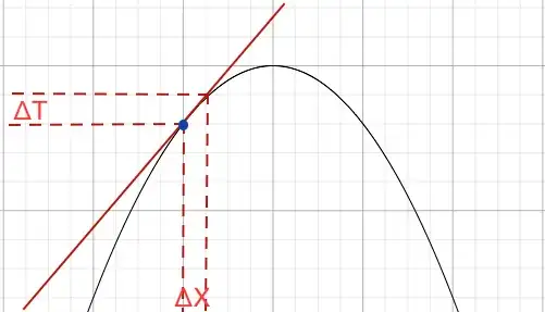

Here's how I would think about it. Imagine you are at the blue dot in the graph below and you are moving along the curve one unit to the right (ΔX = 1). Where will this leave you? You can find out where you will be by taking the slope at the blue point (ΔT/ΔX) and multiplying by ΔT
  • I think this is misleading. While that's where the notation comes from historically, you shouldn't treat $\frac{dx}{dt}$ as a ratio... – A.P. Apr 10 '15 at 22:48
