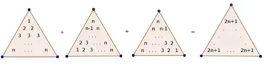

There is a more beautiful Gauss-style proof that involves writing the numbers in triangles instead of in a line.
Gauss style proof
I leave the details to you.
JeremyKun
  • 3,580
    You might want to explain this a bit more. The sum of the numbers in the left triangle is $\sum\limits_{k=1}^nk^2$. Furthermore, the other triangles are simply rotations of the first. Nice proof, and definitely in the spirit of the Gaussian approach. (+1) – robjohn Feb 05 '14 at 04:03
    And the number of 2n+1's in the right is exactly 1 + 2 + ... + n, which we know in closed form. – JeremyKun Feb 05 '14 at 14:18
  • What source was this from? – user17753 Jan 29 '16 at 12:36
    This was told to me by a professor in the Budapest Semesters program. I do not know if it appears in any book. – JeremyKun Jan 29 '16 at 16:13
