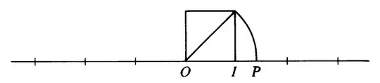

The integers are abstractions arising from the process of counting finite collections of objects. The needs of daily life require us in addition to counting individual objects, to measure various quantities, such as length, weight, and time. To satisfy these simple measuring needs, fractions are required, for seldom will a length, as an example, appear to contain an exact integral number of linear units. Thus, if we define a rational number as the quotient of two integers $p/q, q\neq 0$, this system of rational numbers, since it contains all the integers and fractions, is sufficient for practical measuring purposes.
The rational numbers have a simple geometric interpretation. Mark two distinct points $O$ and $I$ on a horizontal straight line ($I$ to the right of $O$) and choose the segment $OI$ as a unit of length:
If we let $O$ and $I$ represent the numbers $0$ and $1$, respectively, then the positive and negative integers can be represented by a set of points on the line spaced at unit intervals apart, the positive integers being represented to the right of $O$ and the negative integers to the left of $O$. The fractions with denominator $q$ may then be represented by the points that divide each of the unit intervals into $q$ equal parts. Then, for each rational number, there is a point on the line.
To the early mathematicians, it seemed evident that all the points one the line would in this way be used up. It must have been something of a shock to learn that there are points on the line not corresponding to any rational number. This discovery was one of the greatest achievements of the Pythagoreans. In particular, the Pythagoreans showed that there is no rational number corresponding to the point $P$ on the line where the distance $OP$ is equal to the diagonal of a square having a unit side (see the above figure). Their discovery marks one of the great milestones in the history of mathematics.
To prove that the length of the diagonal of a square of unit side cannot be represented by a rational number, it suffices to show that $\sqrt{2}$ is irrational. Many algebraic proofs of this fact exist, and a geometric one is provided in the article linked to at the beginning of this post.
The discovery of the existence of irrational numbers was surprising and disturbing to the Pythagoreans. First of all, it seemed to deal a mortal blow to the Pythagorean philosophy that all depends upon the whole numbers. Next, it seemed contrary to common sense, for it was felt intuitively that any magnitude could be expressed by some rational number. The geometrical counterpart was equally startling, for who could doubt that for any two given line segments one is able to find some third line segment, perhaps very very small, that can be marked off a whole number of times into each of the two given segments? But take as the two segments a side $s$ and a diagonal $d$ of a square. Now if there exists a third segment $t$ that can be marked off a whole number of times into $s$ and $d$, we would have $s=bt$ and $d=at$, where $a$ and $b$ are positive integers. But $d=s\sqrt{2}$, whence $at=bt\sqrt{2}$; that is, $a=b\sqrt{2}$, or $\sqrt{2}=a/b$, a rational number. Contrary to intuition, then, there exist incommensurable line segments.

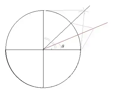

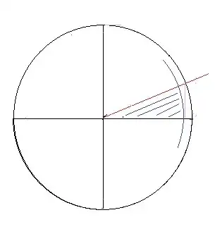

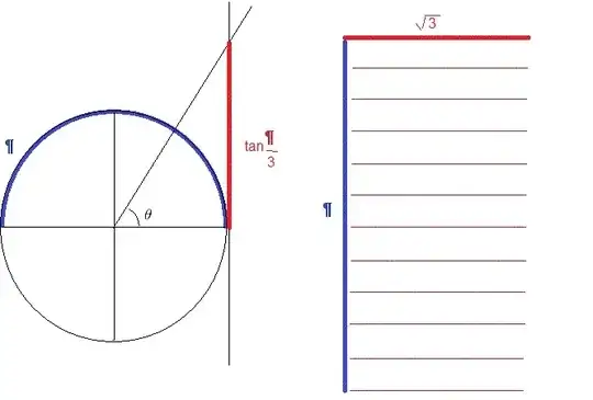

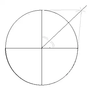

  • I think i might be deviating from original question , but let me bring down my opinion , if maths would somehow kill a body , it maybecause excessive rigor not lack of it , like someone who wastes more than half of his days and non slept nights in scientific researches without any result , that would distract him from serious matters in his life and retard him very backward in age , he would miss many things and wake up on a horible deadly truth cause him to commit suicide or self destruction , btw .... this question seems silly for me to care i prefer the first one bein debated
ok was joking :D time for serious answers
considering an infinite euclidean plan isometry
this graph shows how is a product of two irrational amounts is abstractly feasible (but not perfectly calculable since the human brain conception is bounded to decimal values)
the value shadowed in blue equals to $\int_{0}^{\pi} \sqrt{3}$ ~= $5.44$
the last rounded value is not yet authentic because when we draw a $3.14$ segment perpendicular to $1.73$ long segment we end up with a result nearby $5.43$ this difference of $0.01$ would be gradually and progressivly leading to a killing mistake.
This is an example of deadly inaccuate rounded up error percent.
I will show you now the steps you need to get an irrational product value on your graph paper , take a compass , and a pen , and a ruler with measures.
first draw a circle of radius $r=1Dm = 10cm$ , and draw bissectrice of $\pi/2$ with same compass ...
Take same compass again , draw the bissectrice of the angle $\pi/4$ , now you have an angle $\theta=\pi/8$
Draw the projective point on $x$ axis , then take the same compass , and draw a half circle of radius = the segment from the center to the projection of the angle $\theta$
length of new radius is $cos \theta$=$cos \pi/8$
$cos \pi/4 = cos(2(\pi/8))=2cos²(\pi/8)-1$
$cos \pi/8 = \sqrt{\frac{cos (\pi/4) + 1}{2}}= \frac{\sqrt{\sqrt{2}+2}}{2}$
the surface of the blue shadowed segment = $\pi*r^2/8=\frac{\sqrt{2}+2}{24}\pi$
Now be happy :D you have just drawn an irrational product of class $ \pi*\mathbb{N}^{1/2}$ by your own bare hands !!! and it does never equals the approximate decimal calculation result whic is nearby $44.7 mm$
    in this example i made light on a 11.4 centimetres range mistake that caused death of 25 workers ! have i missed something mr downvoter ? – Abdou Abdou Apr 07 '15 at 15:24
