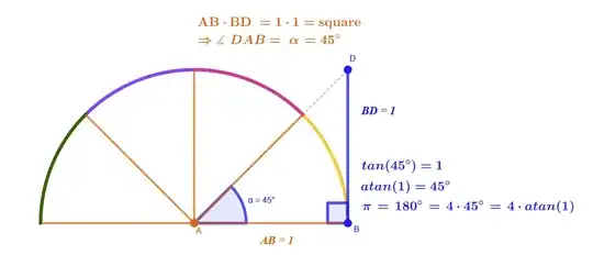

This shows geometric explanation for relationship between tan, atan and Pi.
Because horizontal segment AB = 1 and vertical segment BD = 1, angle alpha = 45°. From there you can use atan( BD ) to determine 45° in radiant and take that times 4 to get Pi.
