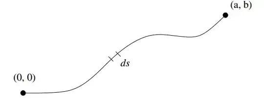

While $y'$ is a function of $y$, from the point of view of the function $f$, it only takes in a vector of real numbers and maps it to a real number. Therefore, having $x$ and $y$ as an input isn't enough. Some problems require $y'$ in the integral, e.g. let's take a simple problem, say we want to the shortest function that connects two points $a$ and $b$. Obviously the answer is a straight line, but let's do this as a variational calculus problem
We have $$ds=\sqrt{dx^2+dy^2}=dx\sqrt{1+y'^2}$$ Therefore: $$F=\int ds=\int_0^a(1+y'^2)^{1/2}dx$$

In the example above, at every point of $x$ between $0$ and $a$, $f$ takes $y'$ at that point (unfortunately this is a degenerate example and only depends on $y'$ and not $y$ or $x$) and pops out a scalar, integrating this gives the length of $y(x)$. This integral is the functional $F$ and all you need to do is find $DF[z]$ and apply the three steps above.
