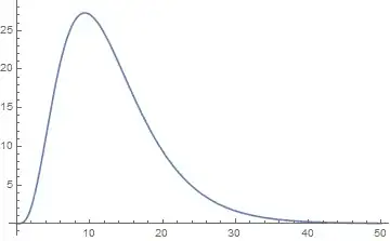

Approach 1: A naive approach is to plot the function given that it has a decaying exponential which tends to zero very quickly. If we plot this function, we see:
So, lets try to approximate it as:
$$\displaystyle \int_0^{50} \dfrac 34 x^4e^{-x^{3/4}}\,dx$$
Using your approach (recall, now your code needs to change to generate random numbers $(a, b)$ and with the function of interest) with $n = 10000$, we get:
$$I = 387.256$$
If we calculate the exact integral we get:
$$I = \Gamma \left(\frac{20}{3}\right) \approx 389.035$$
