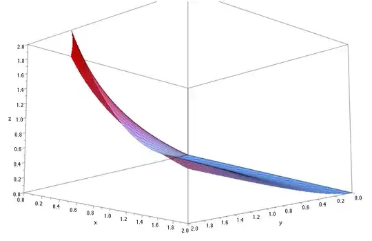

Here is a picture (from below) of your function (convex near $y=0$ and concave when $y$ becomes larger at least in the x=y direction, in the x=-y direction it looks convex...) :
