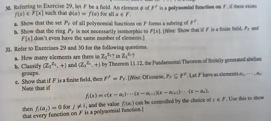

I've got a doubt about a ring of polynomial functions. The problem starting doing this exercise of Fraleigh (The 30).enter image description here
Here I had to show that $P_F$ isn't necessarily isomorphic to $F[x]$. It's easy, since there are infinitely many polynomials in a finite ring, but (If $n$ is the order of the ring) at most $n^n$ polynomial functions in $P_F$ (And seing 31, exactly $n^n$ if $F$ is a field).
