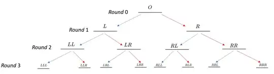

To begin with, we will examine a picture where we have a starting position at some point $O$ and, every round, we can choose to either go $L$eft some positive distance ($\color{blue}{\text{blue}}$ arrow) or $R$ight some positive distance ($\color{red}{\text{red}}$ arrow). Every round, we will keep a running count of all moves made up to that point in time, where the recency of the move is determined by its left-to-right text location...for example, $LRL$ means that the first round movement was left, the second round movement was right, and the third round movement was left.
Picture 1
Now, suppose the distance traversed when choosing the '$L$eft path' is the same distance traversed when choosing the '$R$ight path.' Referencing the terms in Round 2, you should see that $LR$ places you at the exact same location as $RL$. Similarly, for Round 3, $LLR$, $LRL$, and $RLL$ would all bring us to the same location, as would $RRL$, $RLR$, and $LRR$. If we then ask, for a given round, how many ways are there to arrive at one of the possible locations, you should see how Pascal's triangle emerges.

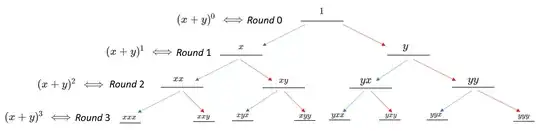

Compare the above photo to the below two, where the $L$eft and $R$ight paths for the $(x+y)^n$ depiction correspond to multiplication by $x$ and multiplication by $y$, respectively; the $L$eft and $R$ight paths for the $[f\cdot g]^{(n)}$ depiction correspond to differentiating the $g^{(k)}$ term while treating the $f^{(j)}$ term constant and differentiating the $f^{(k)}$ term while treating the $g^{(j)}$ term constant, respectively.
$(x+y)^n$ Depiction:
Picture 2
In the this depiction, you will notice that the terms found in each round, when summed, produce the terms found in $(x+y)^{\text{Round #}}$. Why is this so? Well, looking at $(x+y)^2$, note that by the distributive property of multiplication, this is just the summation of the terms $x\cdot (x+y)$ and $y\cdot(x+y)$, which we can rewrite as $x\cdot x$, $x \cdot y$, $y \cdot x$, and $y \cdot y$. But this precisely coincides with the terms that are generated through the blue / red arrows from Round 1 to Round 2. Similarly, $(x+y)^3=(x+y)\cdot(x+y)^2=x\cdot(x+y)^2+y\cdot(x+y)^2$, which once again mimics the blue / red arrow structure because $(x+y)^2$ encodes all elements from Round 2...and all said elements are subject to a blue arrow path (multiplication by $x$) and a red arrow path (multiplication by $y$). Moreover, much like in our traveling positive distances example where we assumed that the $L$eft distance traveled was equal to the $R$ight distance traveled, because multiplication is commutative, we see that $xy=yx$. Similarly, for Round 3, we have that $xyy=yyx=yxy$ and $xxy=xyx=yxx$. This description shows that the computation of $(x+y)^n$ exhibits the same structure as Picture 1's $L$eft / $R$ight structure.

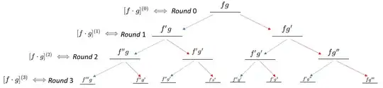

In the this depiction, you will notice that the terms found in each round, when summed, produce the terms found in $[f\cdot g]^{(\text{Round #})}$ As with the $(x+y)^n$ computation, there are properties of the derivative that make the computation of $[f \cdot g]^{(n)}$ structurally identical to the $L$eft / $R$ight traveling depiction. Firstly, for any two functions multiplied together, we know by the product rule that $[\phi \cdot \omega ]'=\phi'\omega +\phi \omega'$. In the $[f \cdot g]^{(n)}$ depiction, this is precisely what the blue arrow / red arrows do! Moreover, because the derivative is a linear operator, we know that $[\phi+\omega]'=\phi'+\omega'$. This feature combined with the previous feature ensure that differentiating the sum of all terms found in a given round is equivalent to taking the derivative of each individual term in that row.
Finally, because of how we described the actions of the red and blue arrows, it should be obvious which terms in a given round are equal to one another. This description shows that the computation of $[f\cdot g]^{(n)}$ exhibits the same structure as Picture 1's $L$eft / $R$ight structure.
