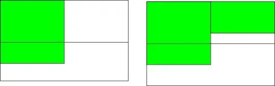

You can get $1/3$ by diving by two, but that will take you an infinite amount of time:
$$\frac{1}{2} - \frac{1}{4} + \frac{1}{8} - \frac{1}{{16}} + \frac{1}{{32}} - \frac{1}{{64}} + - \cdots = \frac{1}{3}$$
We start with the unit square (I marked the $1/3$ line), and add $1/2$:
We take $1/4$ and add $1/8$

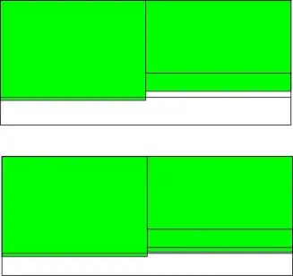

We take $1/16$ and add $1/32$
One more
