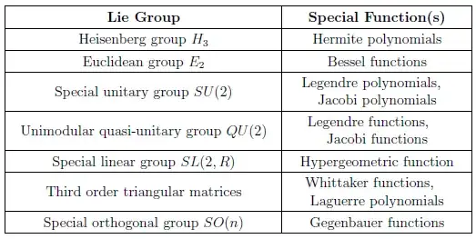

The same idea can explain how Bessel, Hypergeometric functions etc... arise geometrically. Again my question has an example of this. This table:
lists 7 groups and the differential equation each is related to.
My question is asking for an intuitive way to think about the 7 groups listed and what they geometrically mean, and why they relate to some invariance in Laplace's equation $\nabla^2 u = 0$. I even think there are a few different interpretations, e.g. in terms of homogeneous spaces, hyperbolic spaces, etc... so I'm kind of lost.

Some present confusion of mine:
When I look at $SL(2,R)$ and it's matrix representation I have no intuitive picture of the group it's representing or any geometric picture (like a cylinder) to think of that tells me when solving $\nabla^2 u = 0$ will result in the Hypergeometric equation, for example.
If I try to think of $SO(3)$ as the group of rotations of a sphere I get Gegenbauer functions, but Gegenbauer polynomials give Legendre polynomials as a special case. However they also arise from the $SU(2)$ spinor representation of $SO(3)$. My guess is that this all links together because rotations can be decomposed into products of reflections, and spinor representations arise from this simple idea. But is it okay to think of $SO(3)$ as a group of 3-D Rotations and $SU(2)$ as the reflections that generate those rotations?
