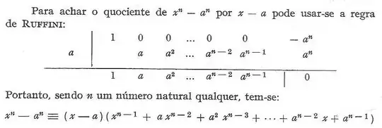

You can apply Ruffini's rule. Here is a copy from my Algebra text book (Compêndio de Álgebra, VI, by Sebastião e Silva and Silva Paulo) where the following formula is obtained:
$x^n-a^n\equiv (x-a)(x^{n-1}+ax^{n-2}+a^2x^{n-3}+\cdots +a^{n-2}x+a^{n-1}).$
alt text
Translation: The Ruffini's rule can be used to find the quotient of $x^n-a^n$ by $x-a$:
(Figure)
Thus, if $n$ is a natural number, we have
$x^n-a^n\equiv (x-a)(x^{n-1}+ax^{n-2}+a^2x^{n-3}+\cdots +a^{n-2}x+a^{n-1})$
