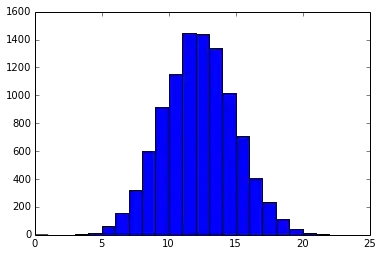

just this week A short proof that the number of division steps in the Euclidean algorithm is normally distributed was posted. The average number of Euclidean algorithm steps is $\frac{12}{\pi^2} \log 2 \log n $. If $n = 10^6$ that number is about $2 \times 6 = 12$.
Here with some Python I compute random gcd's of numbers up to $10^6$. Notice it takes no more than 30 steps (on average about $12$ in agreement with above). In these examples GCD will be $1$ about two-thirds of the time. My code is on GitHub.
Example #3: Connection to Yves Daoust solution
Divide the set $P$ of primes less than 100 and split into two sets $P_1, P_2$. If you randomly multiply only within $P_1$ or $P_2$ you are guaranteed to be relatively prime and smooth. If these two products are less than $10^N$ the expected number of steps is around $2*N$.
