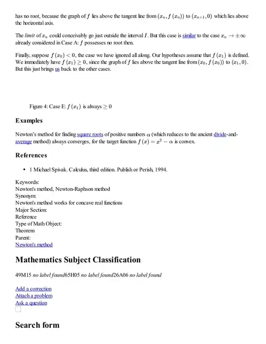

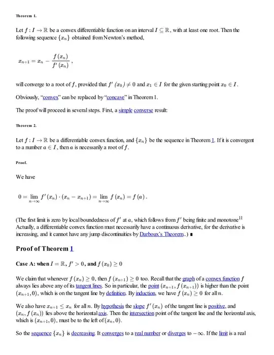

I have not found any references from books, but the cached version of a PlanetMath page (currently down) captures all of the relevant cases (attached). I am posting it to answer the question for other readers.
page 1 page 2 page 3
