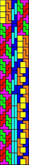

It turns out that if you keep a pile of S, T, and Z in columns 1-4 of a 10x20-cell matrix, and J, L, and O in columns 7-10, you can enter a pattern that repeats every 140 Tetriminos and thus extend the game indefinitely. In 2007, Colour Thief released a proof of this, titled "Playing forever". The following tiling of a 10x56-cell rectangle should help you grasp the pattern used by the proof.
