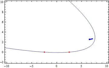

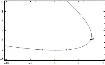

First, a few animations:
parabola focus glissette
parabola vertex glissette
These were generated by a parabola with focal length $a=1$ and distance between two points $c=5$. The first one has the focus of the parabola as the tracing point, while the second one has the vertex as tracing point.
Now, for the mathematics: using whuber's and Blue's comments as a possible interpretation, the question is asking what would be the (point-)glissette of a conic sliding between two points. I'll consider the parabolic case here, since it's the easiest of the three.
Here's the general idea: start with some parabola $(2at\quad at^2)^T$ (where $a$ is the "focal length", or the distance from the vertex to the focus), imagine a chord of length $c$ moving along the parabola, and then translate and rotate the parabola in such a way as to have the chord's endpoints match the two fixed points at $(-c/2,0)$ and $(c/2,0)$.
