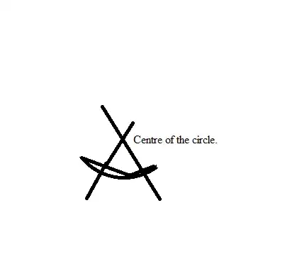

25
Take any three arbitrary point on arc. Now, join these points with each other. Now, Draw Perpendicular Bisectors of these lines. The intersection point of these Perpendicular bisectors would be centre of circle of which the arc is the given.. Since, Any point of perpendicular bisector of Any line segment is equidistant from its end points.enter image description here
curious_mind
  • 1,434
    :+1, great. Also, you don't have to worry about end points, just don't pick any parallel chords. – orangeskid Jan 21 '15 at 10:17
    The picture definitely helps understand why this works. I think a thinner pen stroke would help the clarity of the picture. – Brian J Jan 21 '15 at 21:33

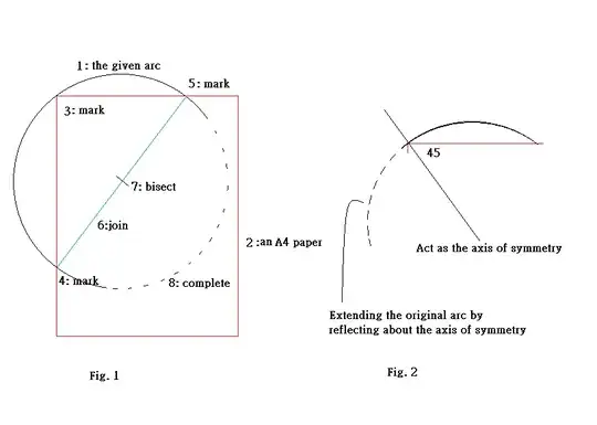

If the given arc is large enough (in the sense of longer than the semi-circle), a large enough A4 sheet can do the required job. See Fig.1.
If the original arc is not long enough, it can be extended continuously by the method described in Fig. 2 until the above requirement is met.
Note also that the line of symmetry can be created by folding up the A4 paper.
Mick
