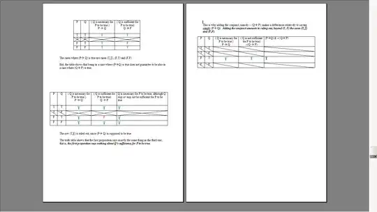

When you say "Q is necessary for P to be true" , that is ( P--> Q) you rule out only one row in the truth table, that is , you exclude the case in which P is true and Q is false.
It means that the cases ( T,T) and ( F,F) are still possible.
But these cases are the two remaining ones ( out of the 3 cases that are still available) in which " Q is sufficient for P to be true" is true, that is ( Q--> P).
So, "being necessary for P" does not by itself imply " not being sufficiency".
This is why " Q is necessary but not sufficient" says more than simply " Q is necessary".
This is also why " Q is not sufficient" has to be added , via a conjunct.
The conjunct rules out the (T,T) case and the ( F,F) case.
Note : in the ordered pairs I wrote, the first truth vale is the possible value of P, the second one is the possible value of Q.
