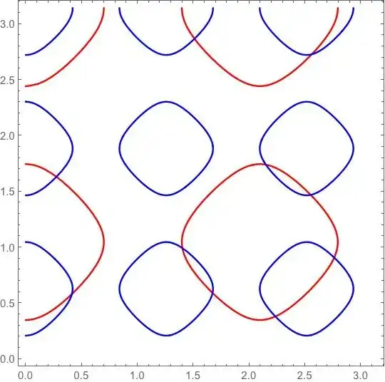

It is sufficient to find the solutions $(a,b)$ in the square $[0,\pi]^2$. In the following figure (obtained by joining two Mathematica contour plots) the large red ovals show the points $(a,b)$ satisfying the first equation, and the small blue ovals show the points satisfying the second equation. One can surmise that the global situation created by these two equations is very intricate indeed. I can distinguish five different kinds of solution points not equivalent under symmetries.
In order to find the solutions numerically use the figure for starting estimates $(a_0,b_0)$ and then proceed, e.g,. by means of the Newton-Raphson method.
