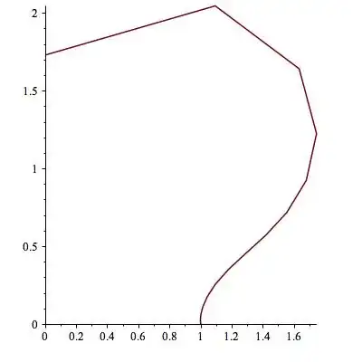

Maple agrees that this converges to $1$ (or something very close to $1$).
The plot shows $z_1=\sqrt{-3}$, $z_2=\sqrt{-3+2\sqrt{-5}}$ and so on (joined in order by line segmants):
seq
added
Note that $f(x)=x^2$ solves the difference equation that you should use: $$ f(x) = x\sqrt{-2x-1+f(x+1)} $$
