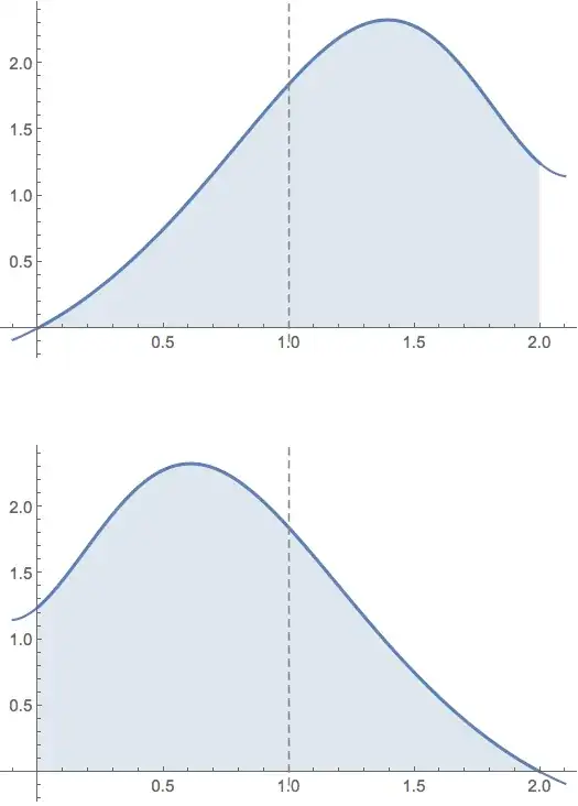

Here's another common example: $$ \int_a^b f(x)\,dx = \int_a^b f(a+b-x)\,dx.$$
The geometric interpretation is simply that the area of a region is preserved by reflection about its midsection.
