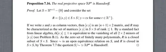

Let $\pi : \mathbb{R}^{n+1} \backslash \{ 0 \} \to \mathbb{R}P^n$ denote the quotient map. In my answer to Real projective space is Hausdorff: is this proof correct? you will find a proof that
a) $\mathbb{R}P^n$ is Hausdorff.
b) The restriction $\hat{\pi} = \pi \mid_{S^n} : S^n \to \mathbb{R}P^n$ is also a quotient map (where $S^n \subset \mathbb{R}^{n+1}$ denotes the standard $n$-sphere).
