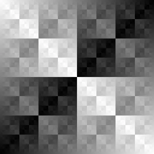

Here's what XOR looks like. Black is $z=0$; White is $z=1$. The x and y axes run from $[0,1]$.
XOR
I used the (naive) formula
$ x \oplus' y = \left(\lfloor 2^{20}x\rfloor \oplus \lfloor 2^{20}y\rfloor\right)2^{-20} $
At least with this naive interpretation, the function does not seem continuous.
EDIT: using analogous formulas, here are
AND: enter image description here
OR: enter image description here
They all look pretty similar, but the 0:1 ratio difference is noticable.
The XOR looks like a fractal, rather than an addition plot.
