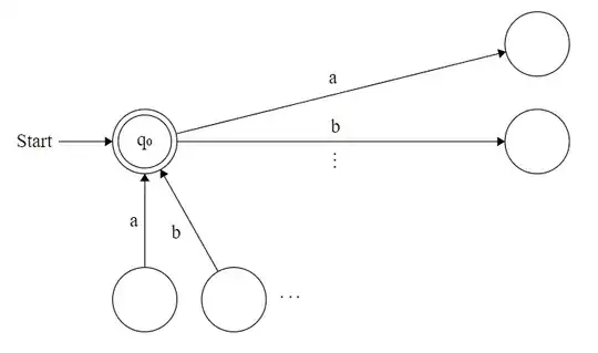

- If $\lambda \in L$, then the initial state must be a final state ($q_0 \in F$). However, we cannot just make it non-final since there might be some transition leading to the state, as the image:

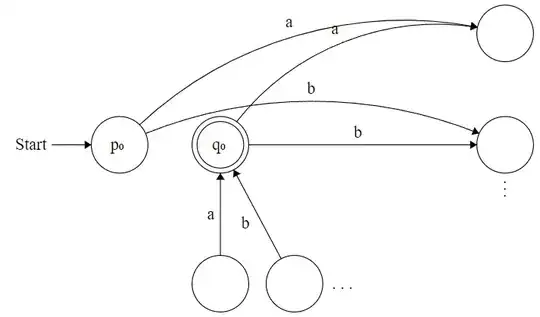

To get around this, we create a new non-final initial state $p_0$ that no transition leads into, and for every $\delta(q_0, i) = q_j$ we add an extra transition $\delta(p_0, j) = q_i$:
This way, we are able to accept all other strings that requires going back to the state $q_0$ but reject $\lambda$, Proving that we can construct a DFA for $L - \{\lambda\}$ if $L$ is regular.
