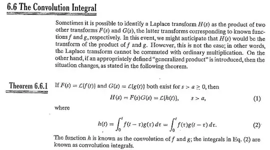

the second kind of convolution in my question there is in page 346 of the book titled "elementary differential equations and boundary value problems" by William Boyce and Richard DiPrima. You can see the picture below.
Suppose that $f$ and $g$ are defined such that they only can take non-zero values on the positive reals, but are zero everywhere on the negative reals. Then
$$\int_{-\infty}^{\infty} f(\tau)g(t-\tau)\; d\tau = \int_0^t f(\tau)g(t-\tau)\; d\tau$$
I think the second case you came across is just a manifestation of your functions being defined that way. That's often implicit in the theory of Laplace transforms for instance or in probability theory (think of eg. the exponential distribution).
