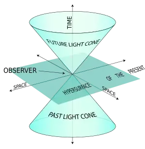

Your textbook says the fundamental solution is $\Phi(x,t) = \frac{1}{(4\pi t)^{n/2}}e^{-\frac{|x|^2}{2t}}$ then we plug into the definition of the energy ball:
\begin{eqnarray} E(x,t,r) &=& \left\{ (y,s): s \leq t \text{ and } \frac{1}{(4\pi (t-s))^{n/2}}e^{-\frac{1}{2}\frac{|x-y|^2}{t-s}} \geq \frac{1}{r^2}\right\} \\ &=& \bigcup_{s \leq t} \left\{ (y,s): |x-y|^2 \leq -2(t-s)\log \frac{(4\pi (t-s))^{n/2}}{r^2}\right\} \end{eqnarray}
So the energy ball lives in (plain-old Galilean) space-time $\mathbb{R}^n \times \mathbb{R}$ and it's fibered by Euclidean balls. This is something like a Euclidean light-cone in physics.

  • pre-kidney's last remark adequately answers the question. The heat ball, much like all characteristic objects of these equations (like the plain ball for the Laplace equation), are not spatial objects. They are characteristic objects stemming from the symmetries of the equation; in the context of mean value theorems they are best viewed as the right 'shape of information distribution'. The shape of actual spatial observables will depend heavily on 1) the manifold where the equation is being solved and 2) the initial-boundary conditions imposed. – guest Jan 01 '15 at 06:12
  • One more remark: john mangual is also correct in drawing the parallel (more than parallel actually) with the light cone, as a similar case of 'shape of distribution of information'. – guest Jan 01 '15 at 06:15
