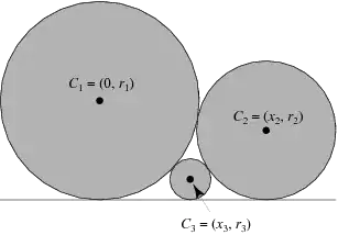

Sorry if this is a foolish question, but I'm having difficulty understanding how to solve for $r_3$ in the following diagram...
Diagram
According to WolframAlpha's page on tangent circles, the radius of $c_3$ can be calculated using the following formula $r_3=\frac{r_1 \times r_2}{(\sqrt{r_1}+\sqrt{r_2})^2}$, which can be simplified to $\frac{1}{\sqrt{r_3}}=\frac{1}{\sqrt{r_1}} + \frac{1}{\sqrt{r_2}}$.
To be completely honest, I'm having a hard time understanding understanding how this formula works (as I'm a very visual person). What exactly is happening here?

This answer to a slightly different problem gives a useful diagram showing how to compute the distance between the points of tangency of two circles and a line, given that the circles are externally tangent (as yours are).
From this we see that if we label the three points of tangency $A,$ $B,$ and $C$ (in sequence from the leftmost such point to the rightmost in your diagram), then considering just the two circles of radius $r_1$ and $r_3$, which touch the line at $A$ and $B$,
$$ |AB| = 2\sqrt{r_1 r_3}. $$
For the other two pairs of circles we get $ |BC| = 2\sqrt{r_2 r_3} $ and $ |AC| = 2\sqrt{r_1 r_2}.$ We can also see that $ |AC| = |AB| + |BC|;$ substituting the formulas we just found for those three lengths (or perhaps even better still, labeling the three distances $ 2\sqrt{r_1 r_3},$ $ 2\sqrt{r_2 r_3},$ and $2\sqrt{r_1 r_2}$ on your diagram),
$$ 2\sqrt{r_1 r_3} + 2\sqrt{r_2 r_3} = 2\sqrt{r_1 r_2}.$$
I can't think of a visual representation of the last step, but algebraically, you can divide all three terms by $2\sqrt{r_1 r_2 r_3}$ to get
$$ \frac1{\sqrt{r_2}} + \frac1{\sqrt{r_1}} = \frac1{\sqrt{r_3}},$$
which is your simplified formula. You can then get the other formula by further algebraic manipulation.
