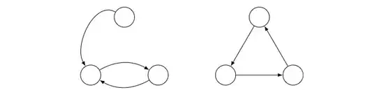

We also have that $T(3) = 8$. We can count them using the following argument: let's call a possible shape a directed simple graph on $n$ unlabelled vertices which is good. For $n = 3$ we have the following shapes:
T(3)
There are $3!$ labelled good graphs of the first shape: fix the outside vertex in 3 possible ways, then fix the loop in two possible ways. There are also $\frac{3!}{3}$ labelled good graphs of the second shape: it's simply the number of cycles on 3 elements. So in total we have: $$T(3) = 3! + \frac{3!}{3} = 8\text{.}$$

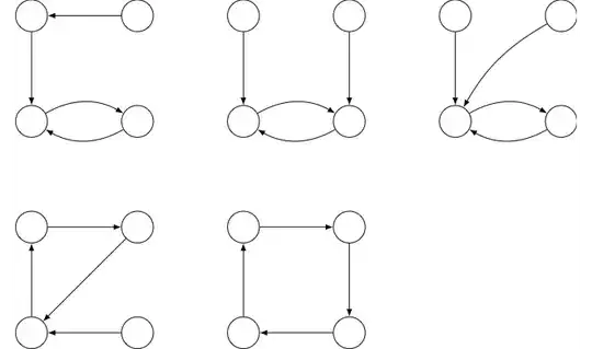

We also know that $T(4) = 78$. Let's list all possible shapes:
T(4)
From top left to bottom right, it's easy to check that we have $4!$ labelled good graphs of the first shape, $2\cdot {4 \choose 2}$ of the second, $2\cdot {4 \choose 2}$ of the third, $4!$ of the fourth and $\frac{4!}{4}$ of the last. In total: $$T(4) = 4! + \left(2\cdot {4 \choose 2} + 2\cdot {4 \choose 2}\right) + 4! + \frac{4!}{4} = 3\cdot 4! + \frac{4!}{4}\text{.}$$
