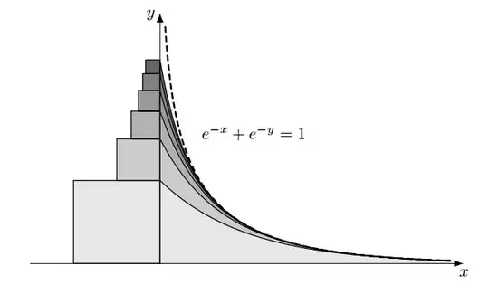

In his extraordinary paper, Mikael Passare presents following visual idea:

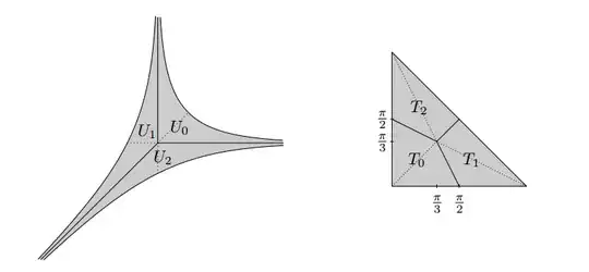

Even more amazing than the above picture are techniques used for the proof. They involve basic math only, essentially trigonometry and more visual transformations of curved (sometimes infinite!) and straight line areas, like this one:
Here all six region have the same area, check the details in the paper.
