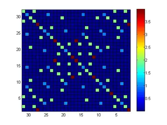

When $n=2$ and sig=$\sqrt{0.001}$, $U$ were generated 10,000 times, with the mean value
\begin{equation}E[U]=\left[{\begin{array}{*{20}{c}} {{\rm{ - 0}}{\rm{.0003 - 0}}{\rm{.0000i}}}&{{\rm{ - 0}}{\rm{.0006 - 0}}{\rm{.0000i}}}&{{\rm{0}}{\rm{.9955 + 0}}{\rm{.0004i}}}&{{\rm{0}}{\rm{.0001 + 0}}{\rm{.0005i}}}\\ {{\rm{ - 0}}{\rm{.0006 - 0}}{\rm{.0000i}}}&{{\rm{ 0}}{\rm{.0003 - 0}}{\rm{.0001i}}}&{{\rm{ - 0}}{\rm{.0002 + 0}}{\rm{.0006i}}}&{{\rm{0}}{\rm{.9955 + 0}}{\rm{.0000i}}}\\ {{\rm{0}}{\rm{.9955 + 0}}{\rm{.0004i}}}&{{\rm{ - 0}}{\rm{.0002 + 0}}{\rm{.0006i}}}&{{\rm{0}}{\rm{.0003 - 0}}{\rm{.0001i}}}&{{\rm{0}}{\rm{.0006 + 0}}{\rm{.0000i}}}\\ {{\rm{0}}{\rm{.0001 + 0}}{\rm{.0005i}}}&{{\rm{0}}{\rm{.9955 + 0}}{\rm{.0000i}}}&{{\rm{0}}{\rm{.0006 + 0}}{\rm{.0000i}}}&{{\rm{ - 0}}{\rm{.0002 - 0}}{\rm{.0001i}}} \end{array}}\right]\end{equation}
and the covariance matrix \begin{equation} V = E\left\{ {\left[ {\begin{array}{*{20}{c}} {{\mathop{\rm vec}\nolimits} \left( U \right)}\\ {{\mathop{\rm vec}\nolimits} \left( {\overline U } \right)} \end{array}} \right]{{\left[ {\begin{array}{*{20}{c}} {{\mathop{\rm vec}\nolimits} \left( U \right)}\\ {{\mathop{\rm vec}\nolimits} \left( {\overline U } \right)} \end{array}} \right]}^*}} \right\}\end{equation}
shown as the following figure (magnitude of the elements in $V$). enter image description here
